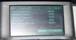

Hello,
I wanted to change language and every time i got message invalid cd.
I have same problem as Janko that wrote before me.
I tried to update my carminat with NAV5-Toutes_versions.nrg.It said that cd version is 3.76 and mine is 3.50. i selected yes.
I got a message Please wait ...
I waited for more than 30min and carminat restarted.
I got same message when i inserted cd first time... NOTHING HAPPENED.
My software was same as before.
it is 0350 3.01.
When i access system information over menu with password 4112 i got this
UCC 3
0376
3.01
I can't change language as before doing update. It says invalid cd in navigation computer.
I tried update procedure with cd that Tomash1 gave link to(it worked for Janko) NAV5.rar
One cd i burned with nero speed 4x disc at once/96
Second one i burned with alcohol 120 24x speed.
I burned both on verbatim media super azo. made in india.
Besides that i have other problem that might be connected with this one.
When i eject my renault card and computer makes complete shutdown after 1min it forgets everything that i made. I can change destination to croatia(split) language to french scale to 100m, i erase something from address book(that is from previous owner of car) and i add my location. After shutdown he forgets everything, language is back to Dutch, It forgets even address book changes, location that i erased is back and destination is back to Italy(Roma)...
Please help me,
Best regards from Croatia
