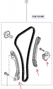

After changing, there was already for 3 weeks no such a rattling noise. So it could be really solution for us.
Part No. is on the picture - 130C12345R. This set is used almost on 22 models of renault and dacia.
Try to communicate with your ASO and ask for changing. Probably it might be broken some "tooth"  on tensioner.

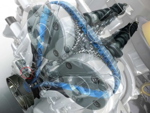

left side of engine... open the cap, where you add engine oil... and look in this hole to the left, you will see part of the chain... of course, other parts of the set are hidden (in the middle of engine) and you won´t see them... It is just for the  illustration.  I ´m close to 12.000 and I´m going to change this set in short time. I personally didn´t change so far nothing. Information is from cars where the change was realized.

of course, it can be clutch, but information delivered to me is that - there is not enough pressure/power that could tighten the chain enough on time.. and it is mostly obvious when you accelerate or breaking by engine going downhill..
look - you dont accelerate pressure is "low", you accelerate pressure is "higher", you dont accelerate and now, pressure is going down, but the stretcher is not able to produce suddenly sufficient pressure on the tensioner (there is something like time gap???...similar to turbo effect - it takes few miliseconds or 1-2 seconds until it is acting) and some "tooth" is going to be broken (this can produce the metal sound or be the cause of this sound) - and this might be the beginning of our problem...
that is for this time all the info I have... now we just need someone, who will go to ASO and ask them to change the part... then, if there will be no unpleasant noise after 2-3 or 4.000 km, we can tell, this was probably the problem... maybe it would be only the half of solution and there will be also the need of changing the clutch... who knows, but we have to start somewhere...
