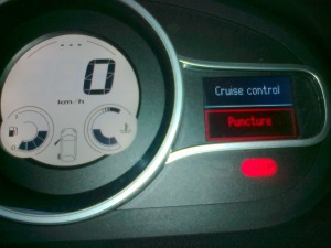

boys, something new with activation of TMPS?

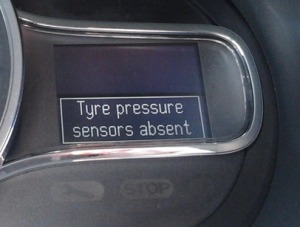

btw. activation is no problem (in cars with hands free card), problem is to establish it in cars with keyless card - information is shown on display only if there is a quick loosing of pressure in the wheel - display shows the wheel (it is black)...
if there is no problem, the display shows message - sensors absent....
my question - how is it possible that sensors are absent, because if the pressure is low, system automatically and suddenly shows the information and shows the damaged wheel...
Maybe the system reads the information sent by sensor when the tire pressure is low, but it does not "see" the sensor when everything is correct. I now that they have special device in authorized service stations which they use to "learn" the system to "see" the sensors, so you may try this with your sensors.

this "learn" is establishing the code of every sensor in UCH, it was done and my UCH see every unique code of sensors, and is receiving the signal, but showing it only in "problem" situation...
it is said, that antennas in car are using diagonals of signal from every sensor and after recalculating these information the display shows tire pressure...
it is even said, that if you change the wheel position, for example from front to rear and rear to front, the system should without problem recognize the new position of every wheel (via diagonals)...
but, there is one person who activated this system only with keyless card system, but the system was working (showing all information - pressure on display) only 2 weeks and then it disappeared...
